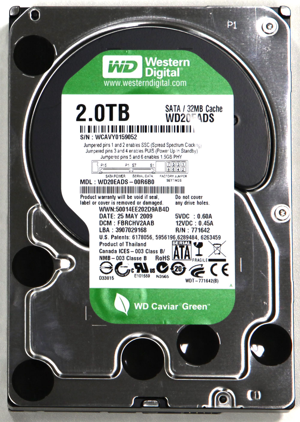

- WD Caviar Green WD20EADS (5400 tpm, 32 Mo de cache)

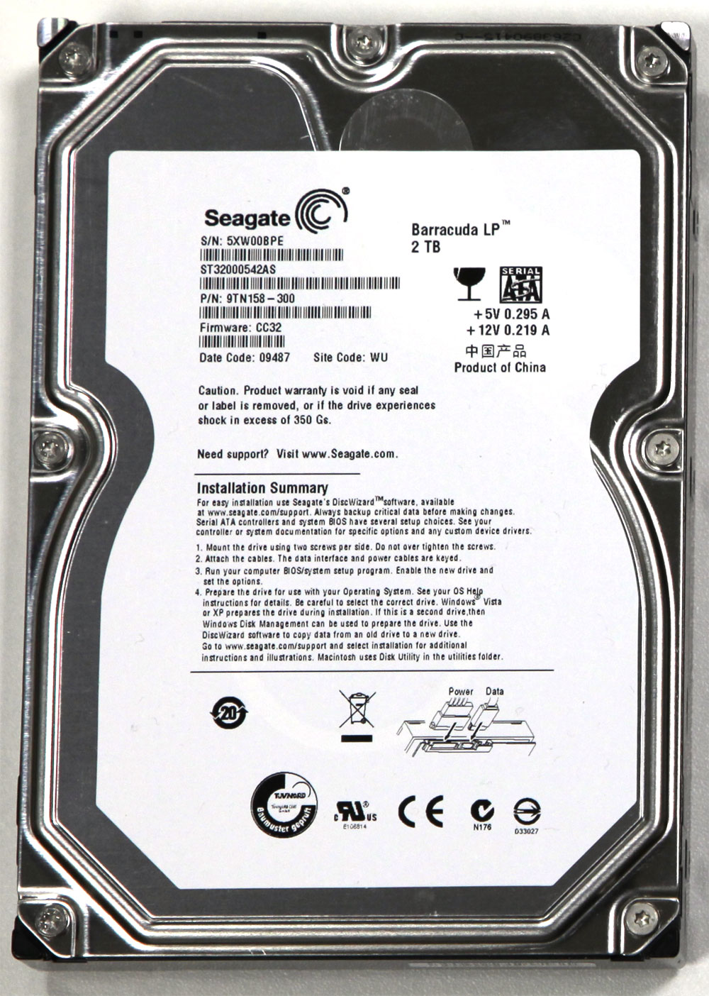

- Seagate Barracuda LP ST32000542AS (5400 tpm, 32 Mo de cache)
